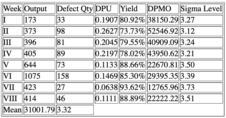

In this measure stage, some analysis has been done to determine the current process condition or current baseline before the Six Sigma improvement methodology is used. This stage is to define the critical to quality (CTQ) aspects and to measure the product performance by calculation the DPMO, which is to calculate how many defects occurred during a period of production and convert them into DPMO and Sigma level values. The previous research data had shown that the average Sigma level during that stage was Sigma 3.32 (see Table 2). This condition is still far from what the company expected which is to achieve minimum Sigma level of 4.0. In the below table we can see the condition of Sigma level during that periods.
Table 2. Sigma Level Calculation
